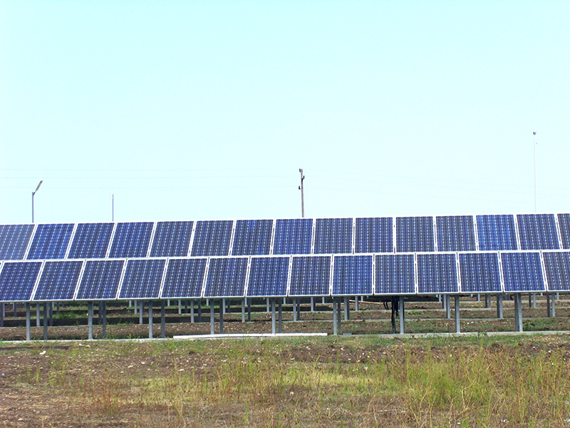

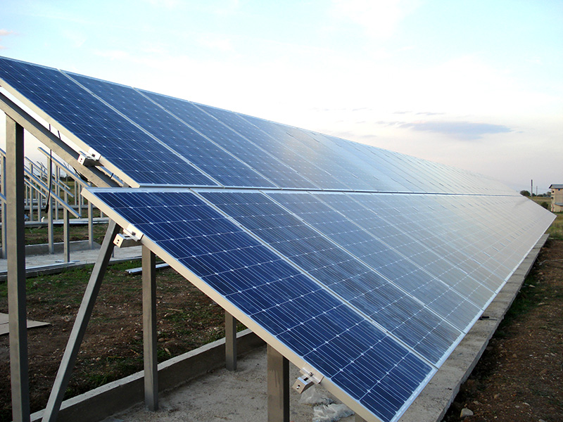

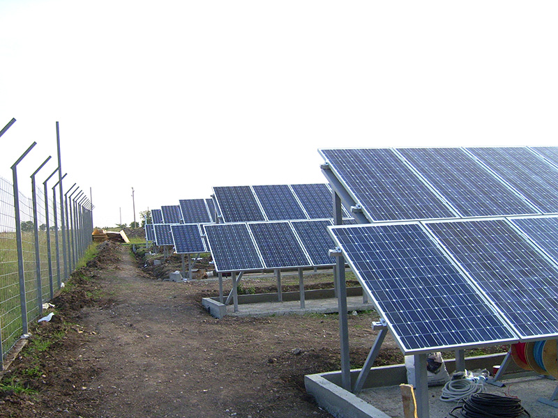

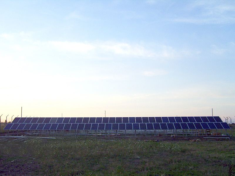

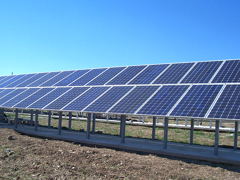

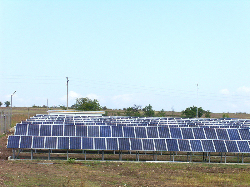

In the construction of the photovoltaic system are used 390 mono-crystalline modules – 195 pcs. SSM 170/24M and 195 pcs. EQS170D-24, all with nominal power of 170 Wp and nominal module voltage of 24V.
The modules form 6 plates of 65 modules with inclination of 32° Each plate consists of 2 rows and on the first are placed 33 modules, on the second – 32. The generated electricity is fed to 6 Sunny Mini Central SMC 10 000TL inverters and to each inverter are connected 5 strings, consisting of 12 serially-connected modules.
Both end modules of each string with DC cable IBC Flexy Sun Sun 1 х 4 mm2 type are connected to the inverter input. The cable is for outdoor, mobile or fixed installation and resistant to weather conditions, high and low temperatures and UV radiation.

The grounding of the PV module frames is guaranteed by their electrical connection with the supporting aluminum profiles. The grounding of inverters, main switchboards and all metal non-current-carrying parts is carried out by connecting them to the grounding circuit, attached to earthing devices. Each grounding device consists of 2 grounding poles 50 х 50 х 5 x 1500 mm.
